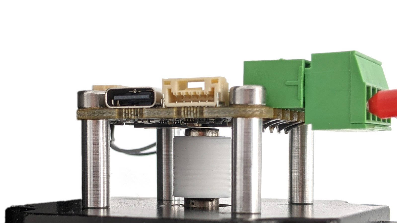

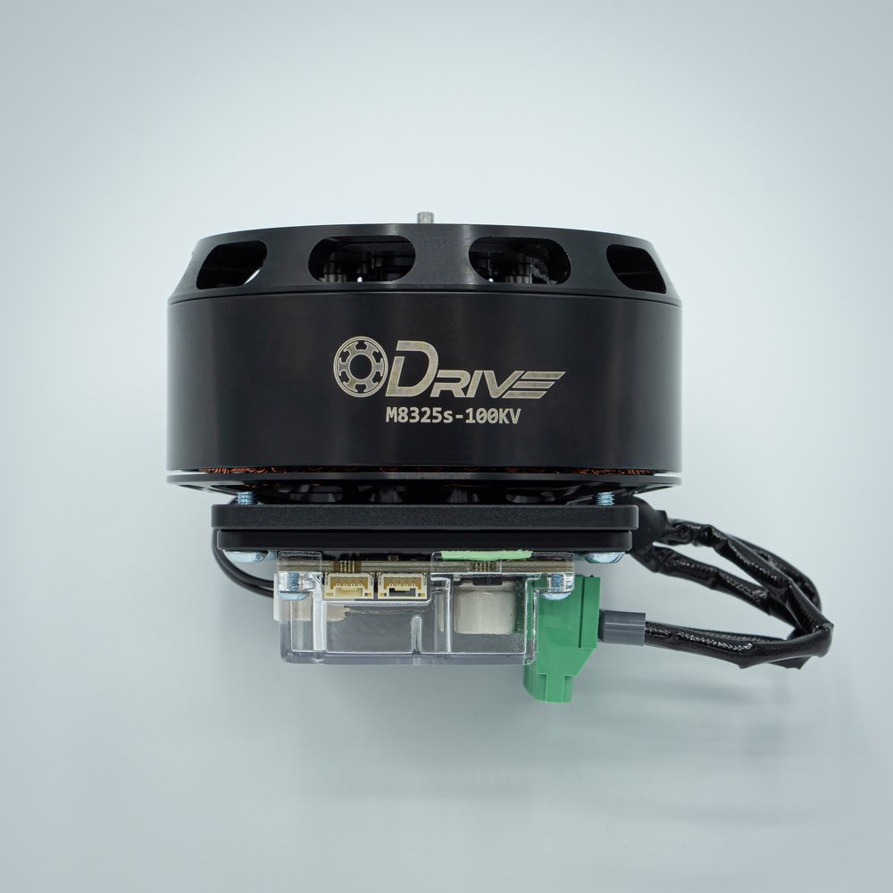

The ODrive S1, ODrive Pro, and ODrive Micro have a built-in MPS MA702 absolute angle encoder. With a properly designed mounting solution, this can save the cost and space of a discrete external encoder.
Side-view photo of an ODrive S1 mounted to a M8325S motor.  The magnetic encoder is robustly protected between the two for high performance control.
ODrive S1 mounted to a M8325S motor. The magnetic encoder is robustly protected between the two for high performance control, both fixed to a motor mounting plate.

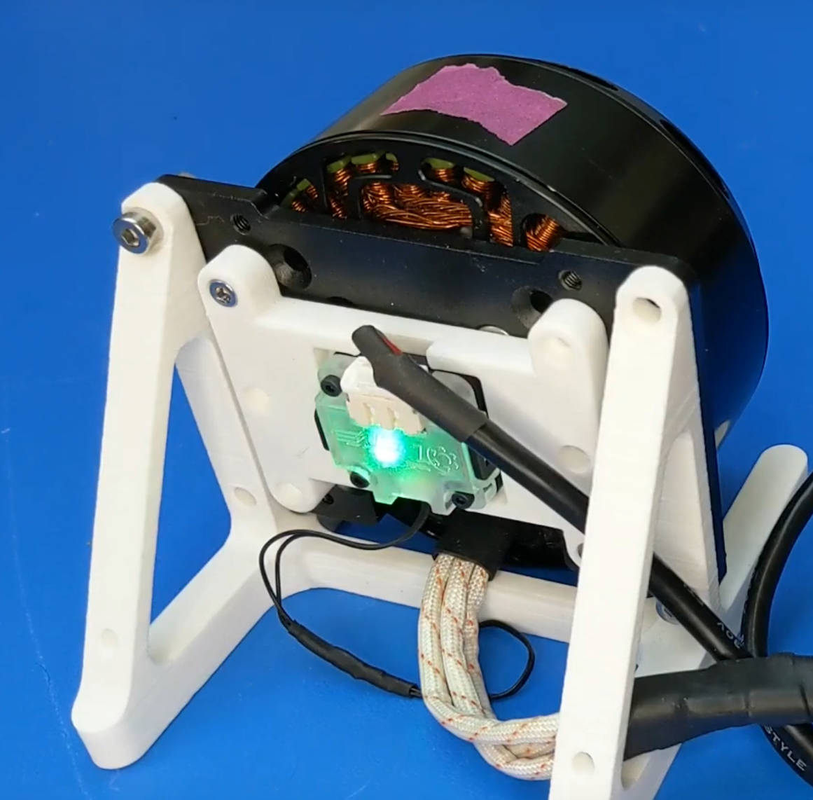

OA1
The OA1 has an indicator LED reflecting field strength. Green is good, otherwise the magnet cannot be successfully read, either being too near or too far away.
Photo of OA1 mounted to test setup, closer to the camera with a brushless motor on the opposite side. The OA1 has a green light visible, diffuse through the casing.
