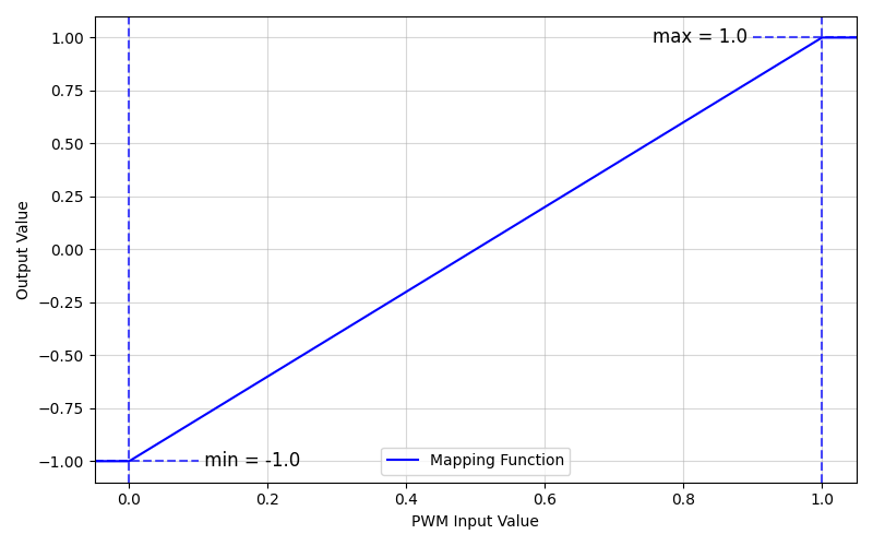

<odrv>.config.gpio(N)_pwm_mapping.minand<odrv>.config.gpio(N)_pwm_mapping.max.
Example PWM input mapping where min = -1.0 and max = 1.0
Note
The max value can be less than min, allowing you to invert the output value slope relative to the PWM input slope.

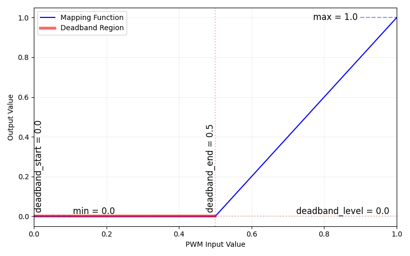

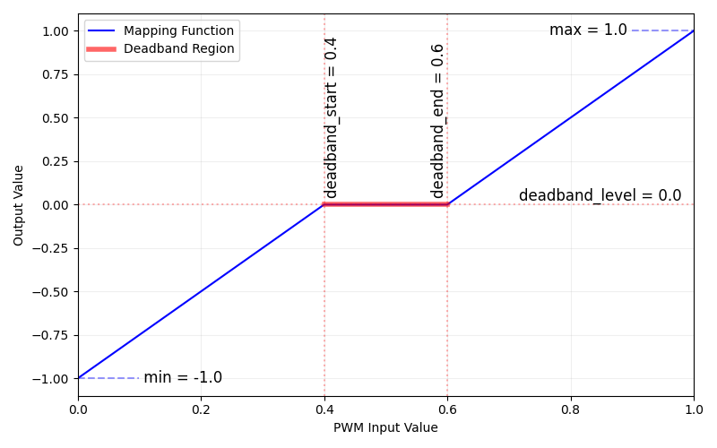

Example PWM input mapping with deadband enabled

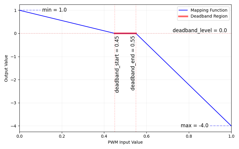

More examples:
Deadband used to create asymmetric PWM slopes. Useful for instance in a mobile robot that requires more fine-grained control when moving forwards than when braking.
This example also demonstrates the ability to have the |
Deadband used to clip the PWM input range 0%-50% to a fixed output of 0. |
