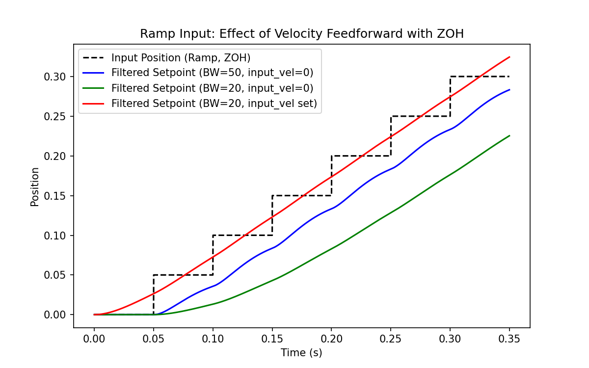

Filtered Position Control
Asking the ODrive controller to go as hard as it can to raw setpoints may result in jerky movement. This is because the ODrive uses Zero Order Hold (ZOH) to retain the value between each sent command data. Even if you are using a continuous trajectory generated from an external source, if that is sent at a modest frequency, the ODrive may chase each stair in the incoming staircase in a jerky way. You can use the second order position filter to smooth out the trajectory.
A good starting point for tuning the filter bandwidth is to set it to the same value as your command sending frequency. For example, if you are sending a position command at 20Hz, set the filter bandwidth to 20.0 [/sec].
You may also set the velocity feed forward in order to significantly reduce the filter lag. See can-msg-set_input_pos.
odrv0.axis0.controller.config.input_filter_bandwidth = 20.0 # Set the filter bandwidth [1/s]
odrv0.axis0.controller.config.input_mode = InputMode.POS_FILTER # Activate the setpoint filter
odrv0.axis0.controller.input_pos = 1 # control the position [turns]
